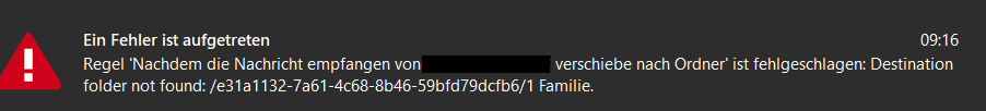

after updating to the new 10.4 Version i am facing problems with the rules. All rules regarding moving mails to another folder lost their focus to the IMAP Folder which was set. I had to manually edit all rules and add the correct IMAP folder again. That was a lot of work in my case.
I have the same issue. None of the rules that are set to move mails to different folder work any longer.
Yes there was a problem where Rules would not run with the new interium 10.4 version.
However this was fixed as @Michal_Burger advised in a later interim release V10.4.4171 as per the below thread.
Since then, there has been other updates and fixes etc in the official release V10.4.4195 which has now been pushed to users and also available to d/l via the release history page.

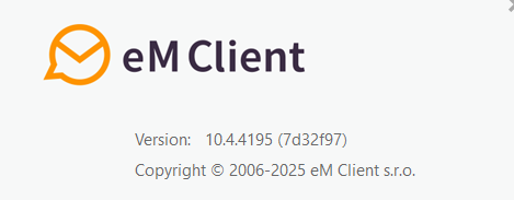

Even with Version V10.4.4195 the target folder from move rules not properly set.
It seems there were 2 distinct issues with email addresses in rules. The second one seems to happen on IMAP servers that use delimiters different than /. We are working on a fix. It should be ready soon (in a few hours at worst). Sorry for the inconvenience. It slipped through the testing process as this scenario is pretty rare.
I got with the V10.4.4195 the same problem as before. It was the first update with V10.4…
So I think the problem hasn`t solved.

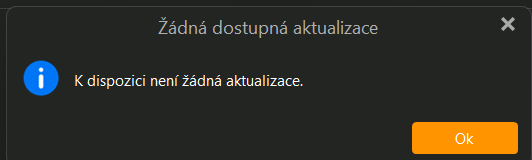

Fixed in version 10.4.4209 which the client does not offer as an update and it is necessary to download it here: Download eM Client for Mac | eM Client
Why do you think the update is not offered? Have you used Check for updates in main menu?
An automatic update is offered only when starting the application and not more ofter than once in 24 hours.
Yes, I updated to version 4195 on Friday, since then I have regularly checked for updates every day and followed this thread, but the update did not load for me, even when I tried to launch it manually, this window always appeared:
On Friday, it automatically offered me the update to version 4195.
