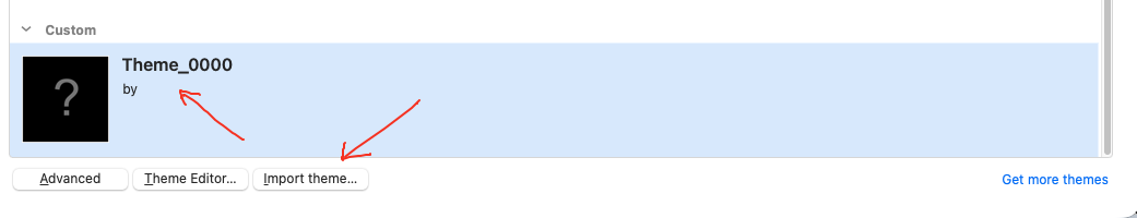

2). Then go to “Menu / Settings / Appearance / Themes” and click “Import Theme” at the bottom. You will then see your imported Custom Theme “at the bottom of Themes”.
3). Click on your Theme and then click “Apply” and “Save & Close” at the top.
4). Then “close and reopen eM Client” and that will then normally show your custom theme.

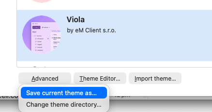

1). “First click on your Theme you want to modify”, and “then click the Advanced button” at the bottom. Then click “Save current theme as” and save it in your “Documents / eM Client” folder.

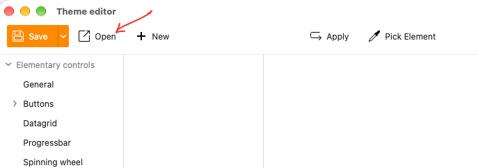

2). Then “open the Theme Editor” and “click Open” to import that saved Theme from your “Documents / eM Client” folder.

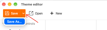

3). Then “Modify the Theme” to what you want, and then “Save the Theme” back in your “Documents / eM Client” folder via clicking the dropdown arrow on the right of Save and click “Save As”, and “Overwright your original saved theme” so it has the modified updates.
4). Then “Close the Theme editor” and go to “Menu / Settings / Appearance / Themes” and click “Import Theme” at the bottom. You will then see your imported Modified Custom Theme “at the bottom of Themes”. Then click “Apply” and “Save & Close” and close & reopen eM Client.
