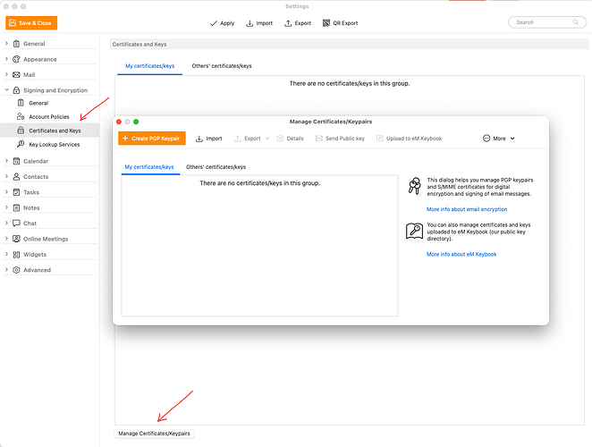

Ho cambiato antivirus, disinstallando Norton dai vari punti di installazione. Non riesco a toglierlo da EM che in posta “ricevuta” mi dice “Norton scanned”: in EM dove trovo la presenza di Norton?

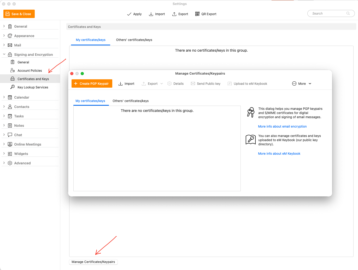

You might have previously setup an Antivirus mail certificate in eM Client which you can check via going to “Menu / Settings / Signing and Encryption / Certificates and Keys” and clicking “Manage CertificatesKeypairs” at the bottom as per the below example.
If there is no Antivirus certificate, and you have Windows, and carn’t uninstall Nortons Antivirus via the normal add/remove in Win 11, then suggest to “use the Nortons Uninstaller / Removal tool” via the Nortons website. If you have Windows 11 you might need to boot up in safe mode to remove it. https://support.norton.com/sp/en/us/home/current/solutions/v20240301142500636
