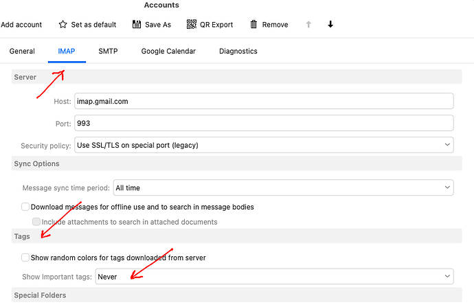

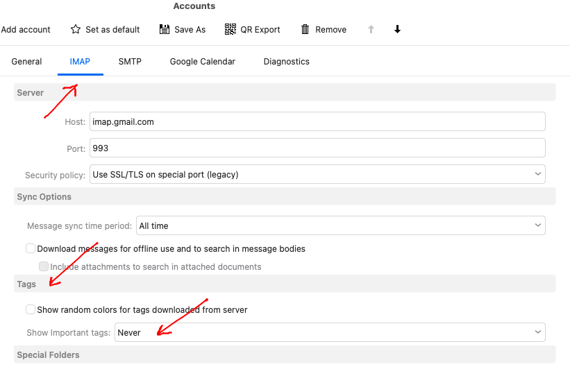

If you do have an actual Gmail account and don’t want to automatically show the Important tag, then go to “Menu / Accounts” and click on your Gmail account "IMAP” tab, and set Tags to “Never” as in the below example. Make sure you “Save & Close” accounts with that option set.
If you dont have a Gmail account and that email keeps being marked as Important, then your mailbox at the server end “might be like Gmail” and have an option to not show the Important tag. Your Fastmail server technical support can advise on that and where that is if it’s not a Gmail account.
