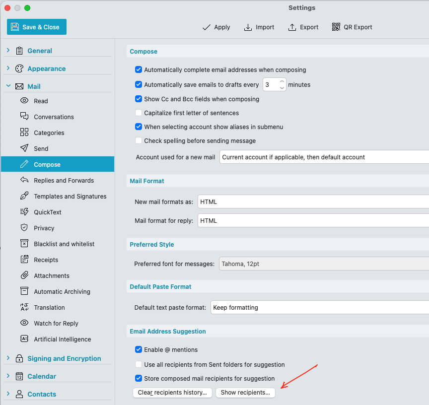

I’m running version 10.3.2619 and have found Settings / Mail / Compose / Email address suggestion / Show recipients but there seems no way to change a recipient’s “Name” on that list - even when I’ve received a reply from them and so now know what name belongs to the address. Am I looking in the wrong place? Many thanks, Bill

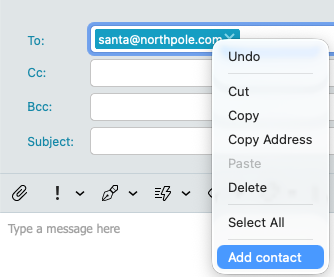

Type a few letters of the email address in the To,Cc or Bcc line and when it appears “right click” on the email address and click “Add Contact” . Then Type a name for that Contact.
Then once you have saved the new Contact, “delete the email address in the To,Cc or Bcc line” and then “type a couple of letters of their name” and it should then appear.

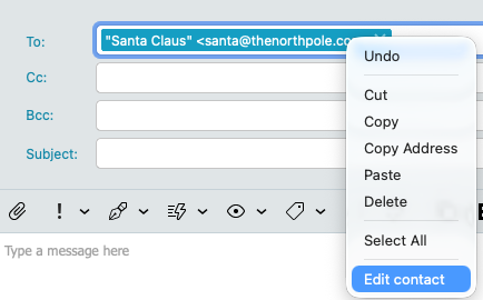

If you then want to edit / change the name, just right click on the name and click “Edit Contact”
If you no longer want a recipient email address “and they are not in your Contacts”, then you can go to “Menu / Settings (Preferances) / Mail / Compose” and click “Show Recipients” and you can click on the email address and delete it as per the example screenshot below.

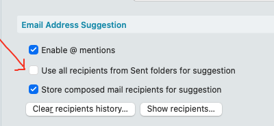

Lastly if you previously typed an email address and it keeps appearing “even after deleting the recipient from the Show Recipients list” then remove / deselect the “Use all recipients from Send folders for suggestion” as in the example screenshot below and Save Settings.
That’s solved my problem. Many thanks!
