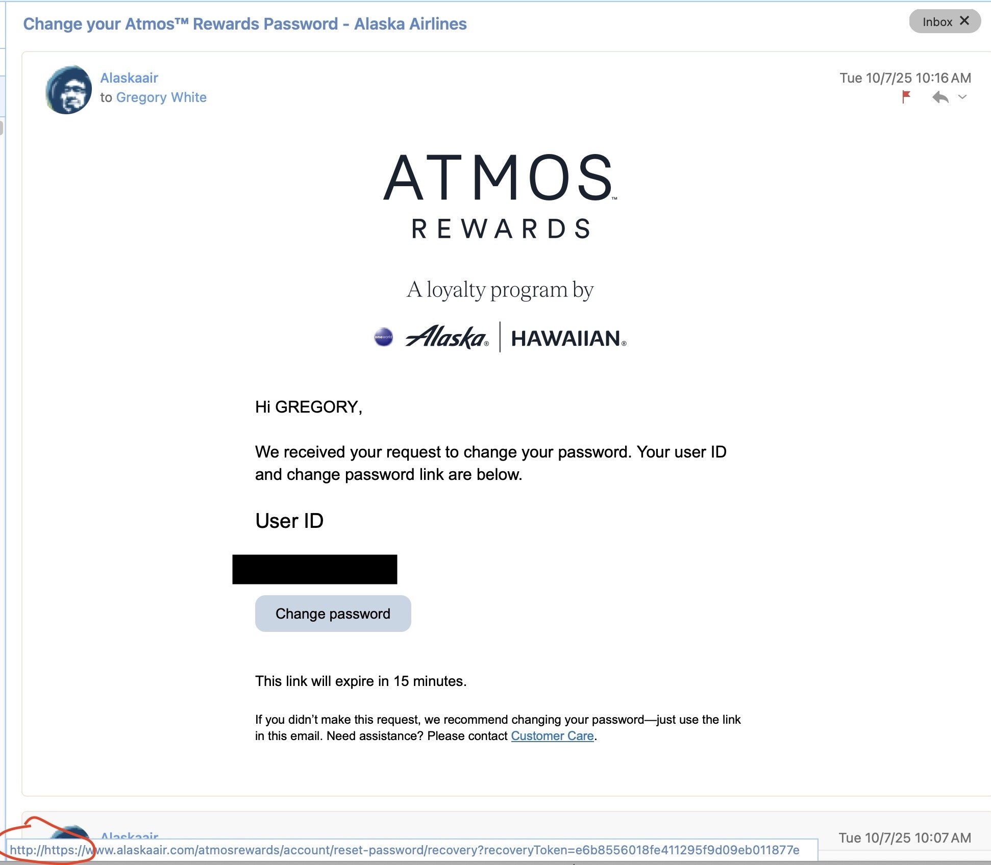

I was able to copy and paste the link from Apple Mail and EM Client. This is how EM Client reads the link:
http://https//www.alaskaair.com/atmosrewards/account/reset-password/recovery?recoveryToken=e6b8556018fe411295f9d09eb011877e
and this is how Apple Mail reads the link:
Now it’s evident why the link doesn’t work in EM Client.

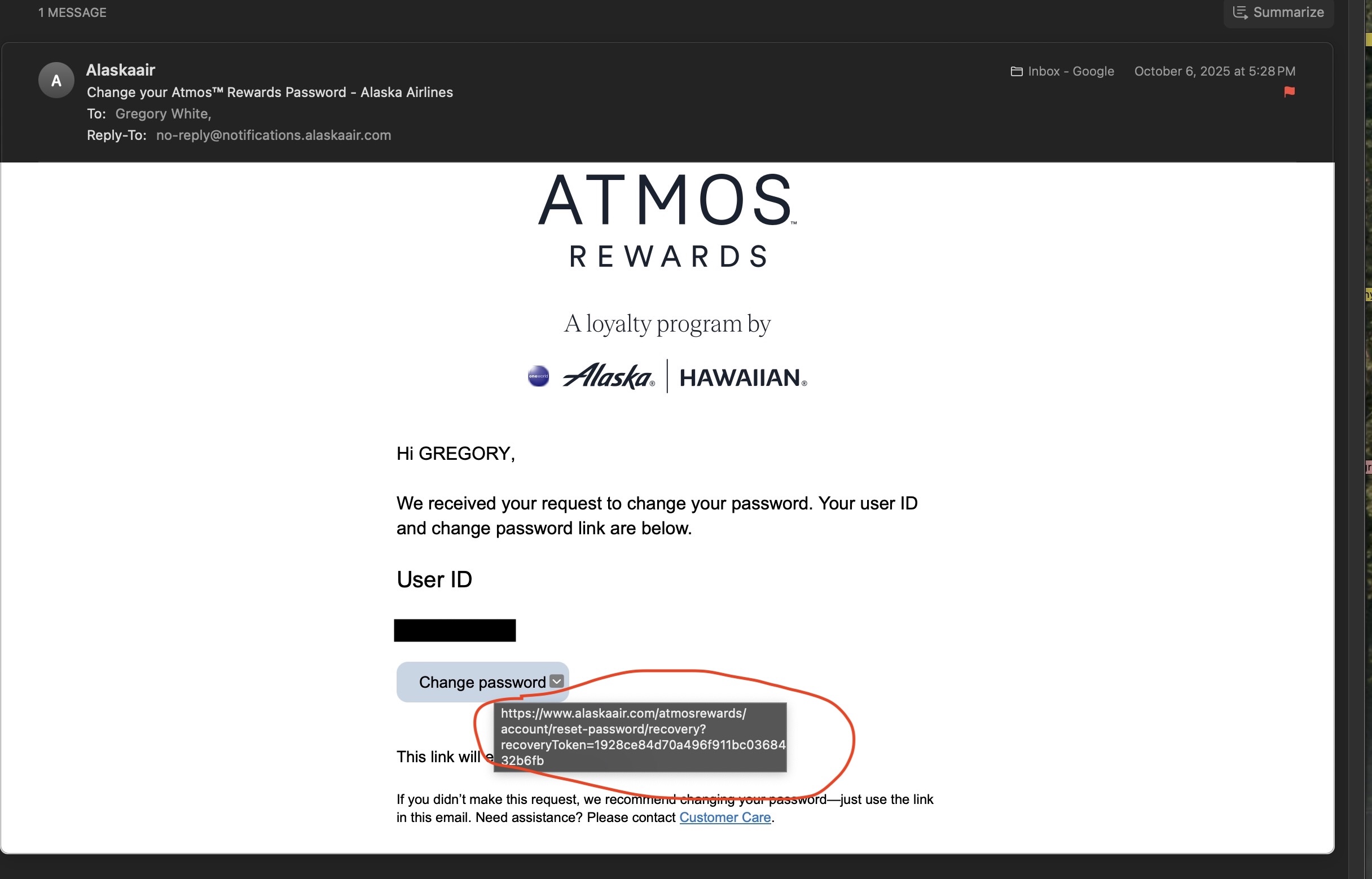

EM Client version See circled part of link at bottom.
Apple Mail version.
