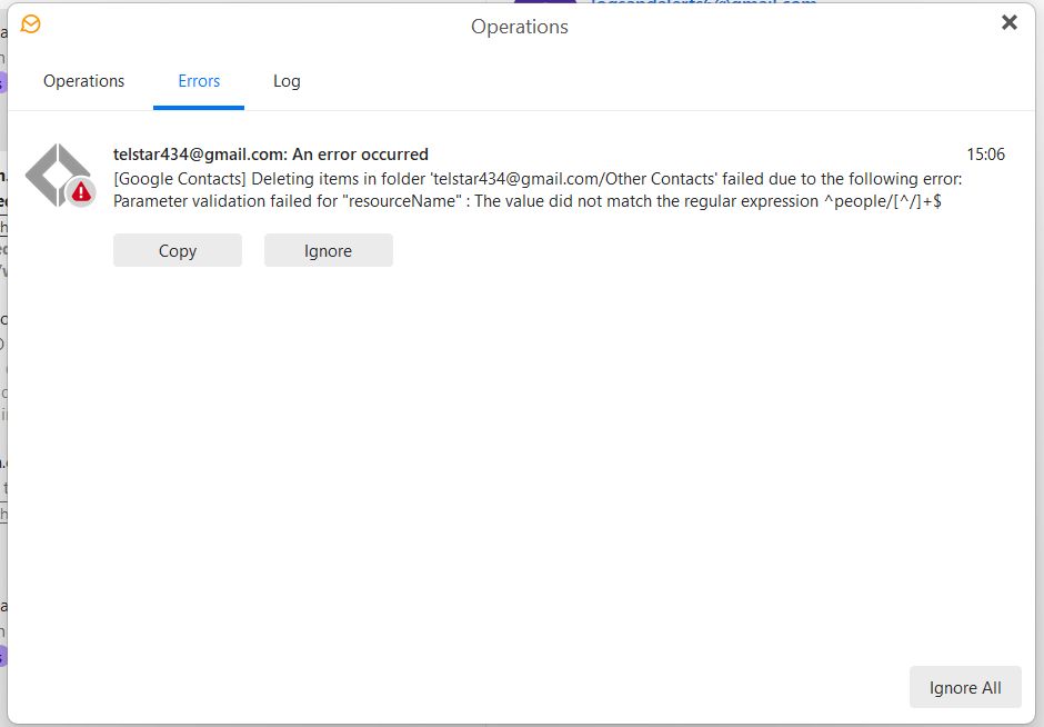

I keep receiving the following error message when I first open eM Client to check my email:
[Google Contacts] Uploading item(s) to folder ‘[email protected]/Other Contacts’ failed due to the following error: Parameter validation failed for “resourceName” : The value did not match the regular expression ^people/[^/]+$
Could somebody please explain what is happening and how can I fix the problem.
Thanks!
That means your eM Client Google contacts in eM Client are not synced or got out of sync with your online Google contacts and you need to run the repair on your account contacts.

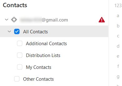

You don’t run the database repair. You do the account contacts repair
So in your case “right click” on All Contacts under your Gmail account and then click “Properties” at the bottom. Then click the “Repair” tab at the top and run the Repair.
If that still doesn’t work, then go to “Menu / Accounts” and remove and readd your Gmail account via the add account “automatic account wizard” at the top.
