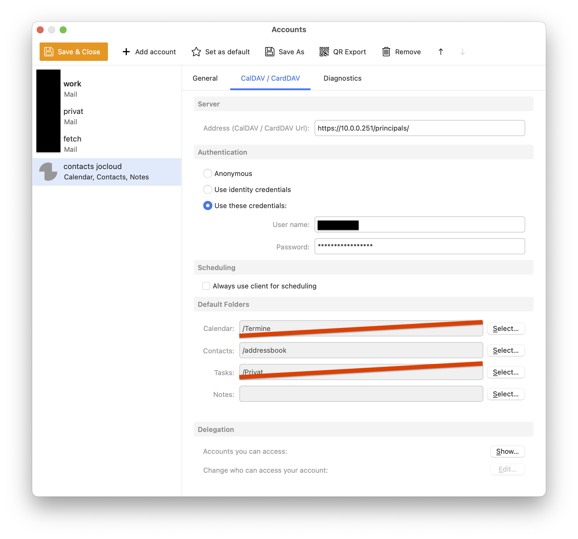

I do not want to use CalDav but continue to use CardDav.
I do not want to use calendar with eM Client. I only use Apple’s Calendar but I use CardDav with eM Client only to access my contacts for composing mails and profile pictures. For everything else I use Apple’s Contacts.
(Entries for Calendar: and Tasks: in screenshot are not editable.)
Can I remove CalDav access including Tasks but keep CardDav access only?
