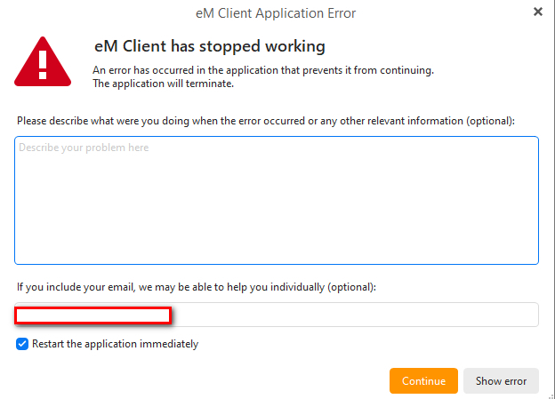

You say you don’t get our crash dialog and it only silently exits the application, right? So there is no such dialog.
All our crashes should normally show this dialog. If not it might be a bit out of our control. In that case we would need crash report from Event viewer.
