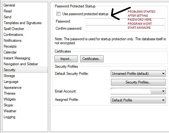

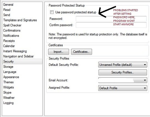

My issue was resolved when I removed passowrd for application start. Only happens after re-checking it...
Can you explain more? Thank you
Unfortunately, I cannot get the program to start at all. I cannot get to the settings menu.
Thank you, I will try it tonight
u have to remove all emc files from users folder on drive, program data depending on windows version you use. not that in program files folder, but in your user folder.
